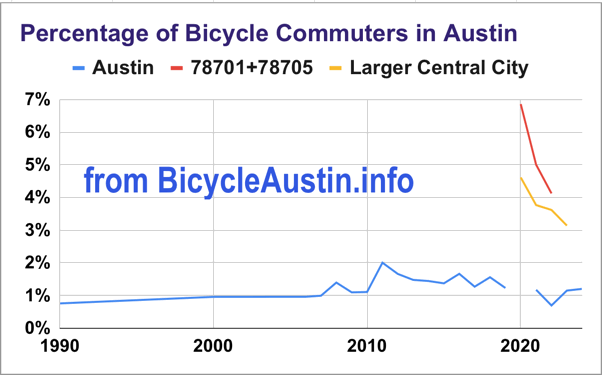

Percentage of commuters who bike to work in Austin, TX
The “Larger Central City” is 78701, 78705, 78751, 78722, 78702, 78704.
From Census data as per below.
The takeaway
Despite the city making a valiant effort to install bike lanes, protected bike lanes, and other facilities over the past 25 years, the percentage of Austinites who bike to work has remained flat at around 1%.  There has been a modest 25% increase since 2000 (0.96% to 1.2%), but that is hardly cause for celebration.  And the actual increase might be even smaller, considering the margin of error.
In the central city it’s even worse, with bike share falling.  This could be an artifact of the margin of error for not enough data.
In 2024, Austin ranked a pathetic 76th out of 246 cities for percentage of commuters who biked to work.

Percentage of Austinites who Bike to Work
Year Austin 78701+78705 Larger Central City
1990 0.76
2000 0.96
2006 0.962539
2007 0.995297
2008 1.397331
2009 1.098495
2010 1.108933
2011 2.005367
2012 1.661531
2013 1.479412
2014 1.444718
2015 1.373951
2016 1.665102
2017 1.271299
2018 1.560542
2019 1.23272
2020
6.85723 4.612805
2021 1.176896 5.003423 3.766636
2022 0.696566 4.124121 3.619059
2023 1.152366
3.140549
2024 1.204736
